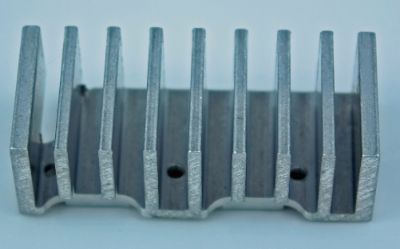

So!!... One of the first things I would highly recommend doing is…… To get at least, the 20mm Heatsink or your going to find yourself restricted to one or two fans per header (depending on fan power draw) before the VRM's get to their cut off point which is around 95°c & will then ramp the fans up to full power (100%) until the VRM's cool down & your fans return to what you set their controler too, This is because, when you regulate the fan speed (Volts) your putting more heat into the VRM's & more fans being regulated means more heat for the VRM's.
With 20mm heatsink fitted you know your going to have enough cooling for the LT VRM’s for at least two fans per header & upto three fans per header (Maybe more if you set a cooling fan blowing onto the VRM area). If you go for the Water Block then you’ll be able to get three to four fans per header easily.
Personally, I’d be getting the 20mm heatsink as a matter of course or as a bare minimum from the start, But that’s just My opinion & own preference with making sure I have enough head room for any fan layout changes I may make in the future J…..
So!!.. Going along those lines.. Here’s a very quick & brief look at fitting the 20mm Heatsink…You know it makes Sense
In the Heatsink Package you get everything you need to fit the Heatsink. Pictured Instructions, Thermal Pads (2 thickness sizes), 3 x Mounting Screws & the 20mm Heatsink
Trim the correct thickness pads for each of the locations pictured on the Installation Instructions
Carefully place the heatsink (taking note to attach it correct way around & carefully but firmly tighten the three mounting screws provided.. DON’T GO MAD!!!
Insure you align the heatsink cut outs with the PC board pots as above
Tighten down the heatsink carefully but firmly & you’ll see it pressing into the Thermal pads & Heatsink feels fairly firmly seated onto the Unit..
